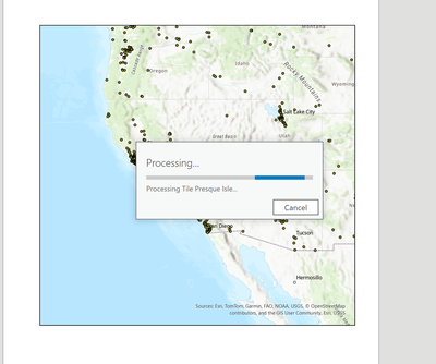

Here is a small video of what my sample does. (Attached)

After sending the requested material, the discussion with @UmaHarano continued via private messages. In order to keep this topic updated, I'd like to briefly report what we found so far.
Uma was able to reproduce the issue, and she also spoke to a Pro developer about this. I don't know all the details, but it seems that currently this kind of scenario represent a limitation for the CancelableProgressorSource window. Uma was able to find a workaround, that basicly consists in adding a slight delay in the cycle after every message update:
