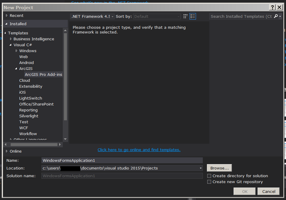

I installed the ArcGIS Pro SDK for Visual Studio via the recommended method in the installation guide.  However, I do not see any project templates in my menu.  Screenshot:
I also tried installing via the .visx installers and rebooting the machine, but I am still not seeing the same menu options that are shown in the SDK docs.  Has anyone experienced this before?
System info: Windows 7 64-bit, Visual Studio 2015, ArcGIS Pro 1.4

Hi,
Please select .NET Framework 4.6.1 in the drop down at the top of the New Project dialog (in the screenshot you have provided).  This will display the templates.  This is the minimum required framework version for ArcGIS Pro Add-ins.
Thanks
Uma

MatthewCallahan1
Thanks - that was it!
