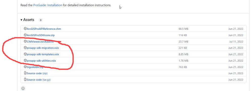

Go to: https://github.com/Esri/arcgis-pro-sdk/releases/tag/3.0.0.36056
Scroll down to  "Assets". Download the vsix's (see image). Double-click to install.
Note: because u have previously installed a later version (3.1), u will need to uninstall those vsix's first. U cannot install an older version on top of a newer version.
