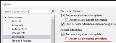

Before installing the SDK, be sure to disable automatic extension updates in Visual Studio. Otherwise VS will push you right back to 3.4.
After that, head to the Github releases page (https://github.com/Esri/arcgis-pro-sdk/releases). If you scroll to the bottom of the 3.3 section and expand the Assets, you'll find the .vsix files.
tempStephenRhea_NV5
RichardMoussopo
That did the trick, thank you
