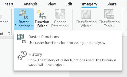

I'm creating a custom addin and would like to create a button menu similar to the Raster Functions one shown below. What is this button type called and is it possible? Also, is there a visual list of all possible button types, what they look like and what they do?

Hi.
That type of button is called a Split Button, and can be created with the ArcGIS Pro SDK template. You can find more information about the split-button and the other types of buttons on the ArcGIS Pro SDK wiki. Unfortunately I don't any pages or sites where you can see a graphical display of each kind of button and other user interface elements.
