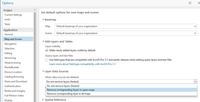

One related side question: I noticed that specifying a path in the Delete GP Tool no longer removes map layers from the map that have that path as a data source. Is that expected behavior?  Does anyone know when (which version) that change occurred?

Re: my "One related side question" in the original post,  Do you know if is was an expected behavior for the Delete GP Tool to stop removing the map layers with the deleted data source?  And if that change is new in ArcGIS Pro 3.3?

Re the Delete GP Tool no longer removing map layers with deleted data source.
There was a change at 3.3 with the behavior of data sources being deleted and renamed.  The default behavior is now NOT to remove layers when this occurs  I believe this change was made for performance reasons.
However, you can alter this default behavior to revert back to the previous behavior.  There is a new setting in the backstage options under the Map And Scene tab. See the Layer Data Sources expander where you can set the value for both deleting and renaming of data sources independently.
Narelle
