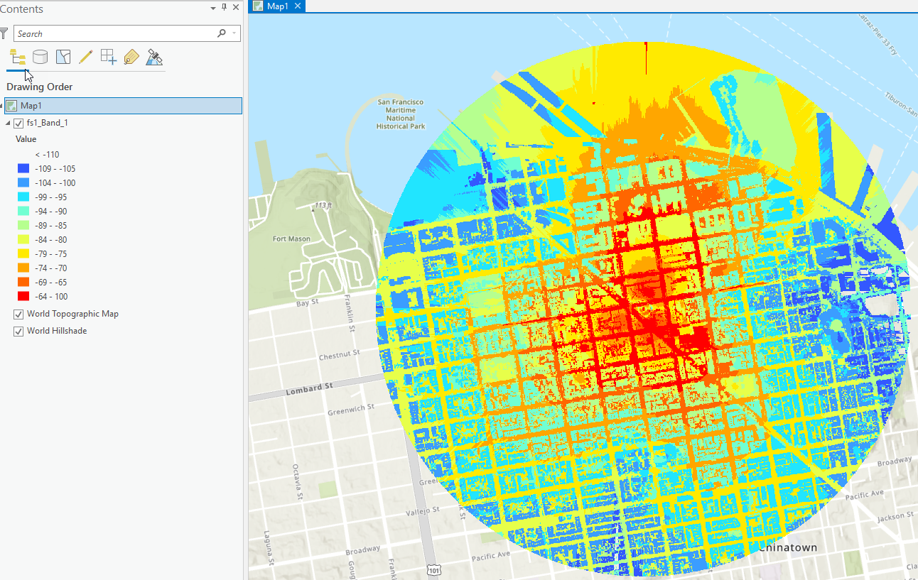

This is what I did -
In the zip file there was a prediction.lyr file.  At this point in 2.4, the new methods to apply symbology using the layer definitions from a .lyr doesn't work with 2.4. This will hopefully be fixed soon.
I added the prediction.lyr to Pro, fixed the data source by pointing to the grid layer you sent.  I then saved it as a lyrx file. I have attached this lyrx file as FS-Prediction.lyrx. This lyrx file had a CIMRasterClassifyColorizer.
I then used the code below to apply the symbology from FS-Prediction.lyrx to the grid you sent and it worked for me.  Note: the lyrx was not loaded in Pro when I did this.

UmaHarano
Hi
The problem is that when you are applying the symbology, the layer has not been added to the map yet. When I tested the workflow in your snippet, I see the same issue.
Try this:
1. Create the layer and await.
2. Then apply the symbology.
This code does this:
