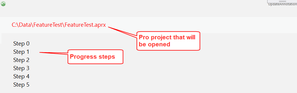

You start Pro with the above command line, the default startup screen has been replaced by a custom startup screen which is showing the progress of your workflow (see the StartupUI folder) :

  RunOnUiThread(() => _startupPageViewModel.TheProject = projectPath);
  for (int i = 0; i < 10; i++)
    RunOnUiThread(() => _startupPageViewModel.TheStatus += $"Step {i} \n");
