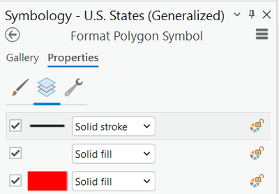

Symbols are made of layers. You can extract the symbol layers from your renderer's symbol and add the fill symbol to these layers. Here is a code snippet
var renderer = lyr.GetRenderer() as CIMSimpleRenderer;
//Get the renderer's symbol and cast it to the type of symbol
var polygonSymbol = renderer.Symbol.Symbol as CIMPolygonSymbol;
//Get the layers in the symbol
var symbolLayer = polygonSymbol.SymbolLayers.ToList();
//Create a solid fill symbol layer
var fill = SymbolFactory.Instance.ConstructSolidFill(ColorFactory.Instance.RedRGB);
//Add the fill to the symbol layers
symbolLayer.Add(fill);
//Set the symbol layers back to the symbol
polygonSymbol.SymbolLayers = symbolLayer.ToArray();
//Set the symbol back to the renderer
renderer.Symbol.Symbol = polygonSymbol;
//Set the renderer back to the layer
lyr.SetRenderer(renderer);
You can see the renderer's symbol layers in the UI Like this:

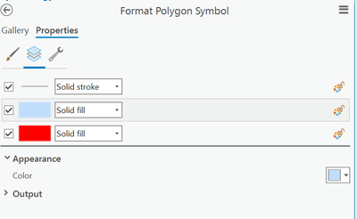

Daniel4
Hi Uma, thanks for your answer.
I added the new fill, and can see it like this:
But is there a way, to turn off the visibility of the middle symbol layer?
UmaHarano
Since you have access to the SymbolLayers, you can manipulate any of these layers.
//Can modify the layers in the symbol anyway you want.
