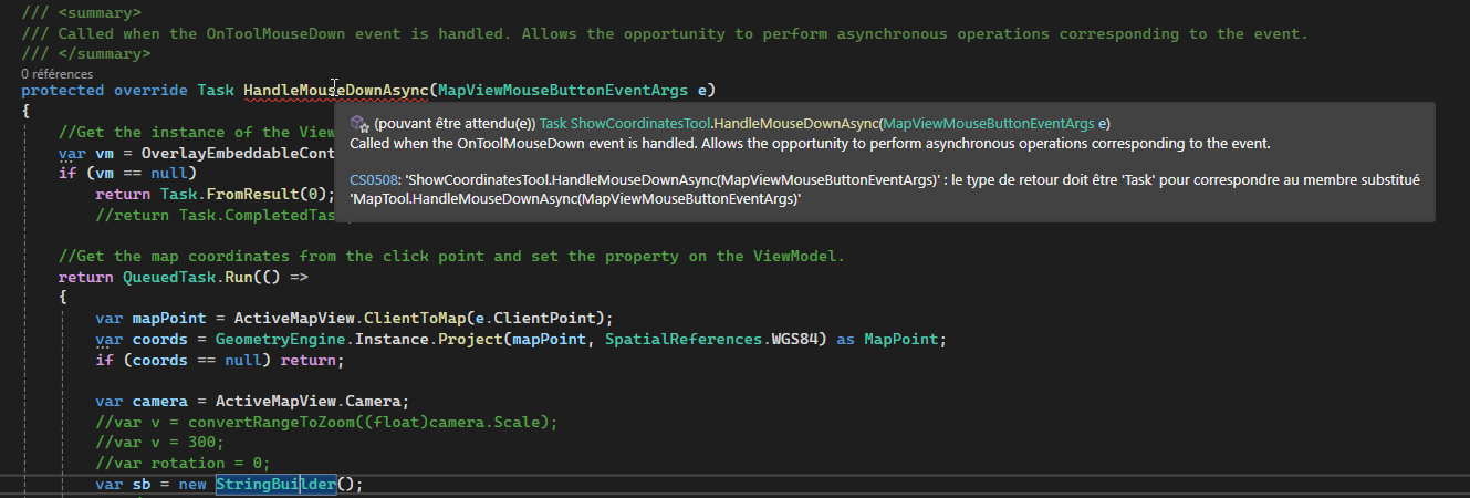

I used a plugin in ArcGIS Pro 3.2, and after migrating it to ArcGIS Pro 3.3, my esriaddinx plugin no longer worked. When I examined the source code, I noticed a new error message:
Error message : "Gravité Code Description Projet Fichier Ligne État de la suppression
Erreur CS0508 'ShowCoordinatesTool.HandleMouseDownAsync(MapViewMouseButtonEventArgs)' : le type de retour doit être 'Task' pour correspondre au membre substitué"
in English (translated) : "Severity Code Description Project File Line Deletion Status Error CS0508 'ShowCoordinatesTool.HandleMouseDownAsync(MapViewMouseButtonEventArgs)': return type must be 'Task' to match overridden member."
Did you notice the same issue ?
protected override Task HandleMouseDownAsync(MapViewMouseButtonEventArgs e)

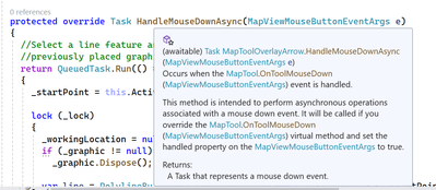

I cannot duplicate your issue.   When you say you migrated your add-in to 3.3 did you upgrade your project to target .NET 8.0?  I have a 3.1 add-in with a MapTool that also is using the HandleMouseDownAsync  overrise and it worked fine under 3.3.   When i migrated the project to ArcGIS Pro 3.3 i get the following when i hover over the HandleMouseDownAsync override:
Also can you check the definition for Task?  It should be defined as follows:
