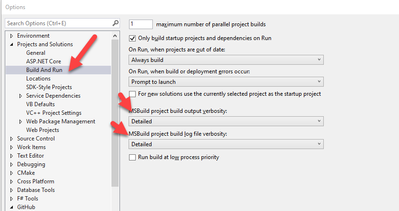

If you don't already have this option turned on, can you please turn on the Visual Studio verbosity option to detailed?
And then, if you can compile your project, please check and see in the output exactly where RegisterAddIn.exe is being invoked from.
