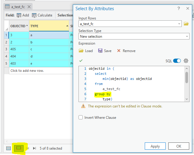

Bud

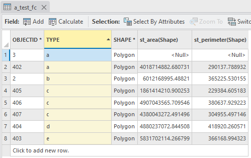

This isn't what you're asking for, but it still might be of interest:
We could get a list of unique values for a given field using a SQL subquery. A subquery would work in mobile and enterprise geodatabases, but I couldn't get it to work in a file geodatabase.
Sample data (the TYPE field has duplicates):
Option 1 — Use Select By Attributes: (or a definition query)
 objectid in (
    select
        min(objectid) as objectid
    from
        a_test_fc
    group by
        type)
Option 2 — Create a database view: (or a query layer in an enterprise geodatabase)
select
    objectid,
    type
from
    a_test_fc
where
    objectid in (
        select
        from
            a_test_fc
        group by
            type)
order by
    type
Edit: In hindsight, I didn't need to include the OBJECTID as a field in the view. I could have just used the TYPE field as the unique ID.
Those techniques give us a "list of unique values" in the attribute table. We're querying for the first arbitrary row in each group.

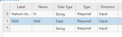

Just throwing my solution in the mix in case it's helpful to someone. I created a new tool in ArcGIS Pro with two parameters to input the name of the Feature Class (must be present in the current map) and another for the Field.

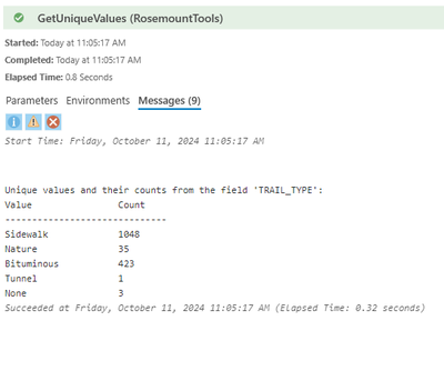

When I run the tool it looks like this:
And the output looks like this in the Details window after running:
