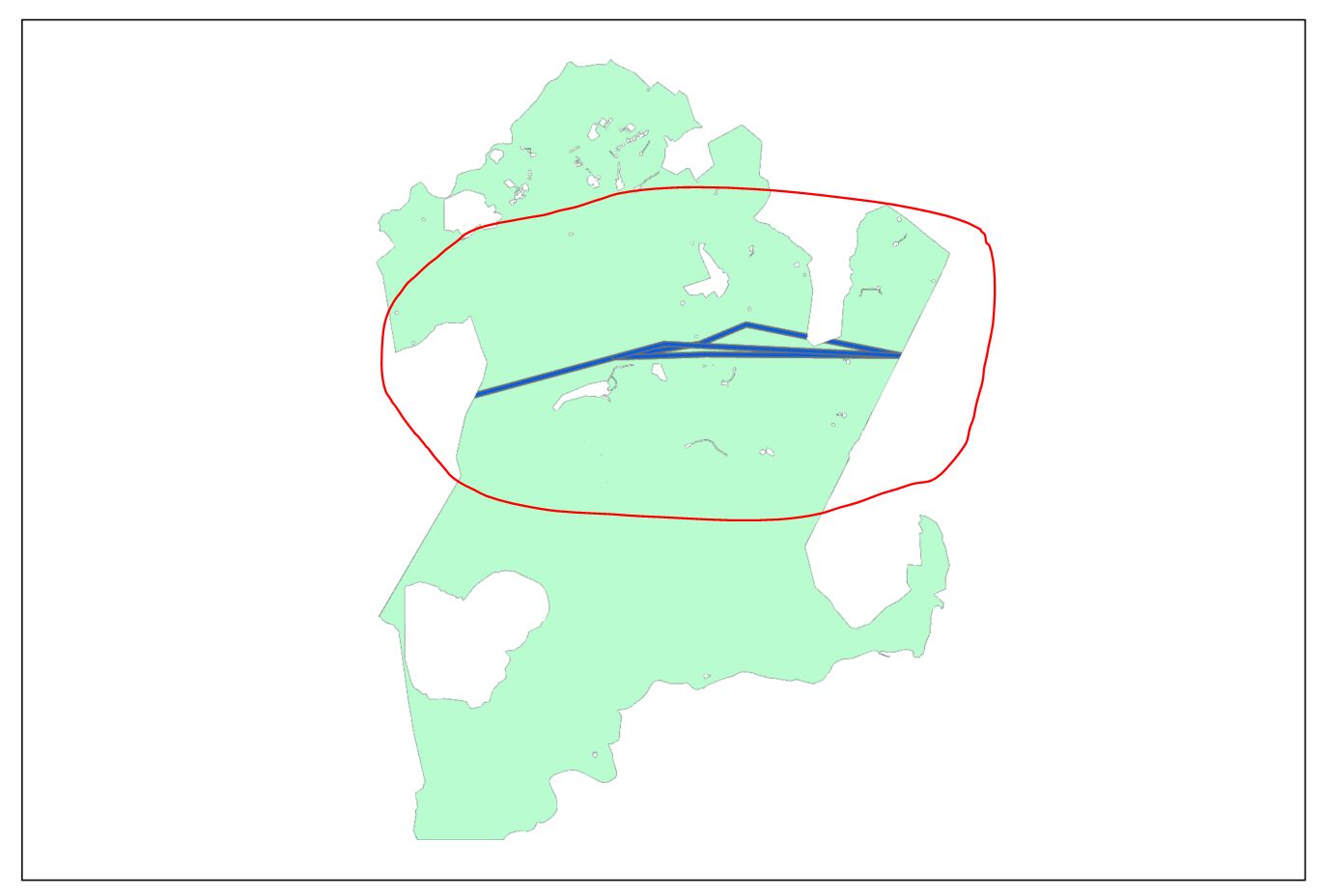

Fellow GIS professionals, I have a polygon feature containing individual polygon for each land parcel, which is intersected by another polygon/and polyline containing power lines and powerlines buffers, I need to create MapSeries for each parcel, clipping the powerlines within the extent of that specific parcel only, which is simple. But!! I also need to export the MapSeries zooming into the area of intersection only, and not the whole (default) full extent of the parcel, map series extent options are limited to best fit, fixed scale, or scale from field, is there is a way to achieve this, maybe through ArcPy? In example picture attached, I want to only zoom-in to the area marked in red as an example, in each of the parcel plans.

In this situation we could possibly do the following:
  • Use the 'Intersect' tool to output a polyline feature class of line features clipped by the parcel polygon features.
  • Use the above output as the MapSeries input
  • Hide the output polylines underneath the powerlines layer in your contents list and exclude it from your legend
Would the above work well enough in your situation?

WaddahMahmoud
Here is a crude script put together based on your suggested approach, I initially thought that you can access the MapSeries and manipulate the scale using ArcPy (mind you, not a pro python user! so maybe there is a way that I just don't know about), but for now, this script at least spared us the torture of the manual steps.

WaddahMahmoud
Hi Glen,
Appreciate the quick response. I should have elaborated further, your solution is what we actually have in place to export the maps, the process is roughly something like this: Intersect all layers within the parcel, can be more than one > Dissolve based on the parcel number field > use page query on all layers. Since we have Pro license which allows for only 2 feature intersections, and both parcels and powerlines features, or other affecting features changes frequently, this becomes a cumbersome process, I was after a more automated method to apply to the map series.
for example:
  • Create list of features to intersect.
  • Loop through the list and perform intersect.
  • Merge result with Parcel.
  • Finally, dissolve the merged layer.
