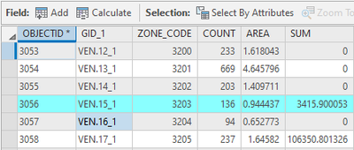

I got administrative maps level 1 shapefile from GADM [gad,.org] and Agriculture production Geotiffs from SPAM [mapspam.info] and run Zonal Statistics as Table SUM

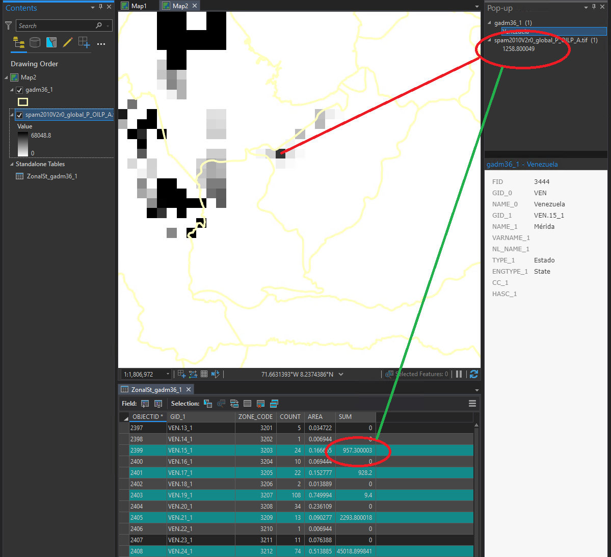

The picture shows that for region VEN.15_1 the calculate sum is much smaller than the value in the indicated pixel, which centroid is within the region.
That problem repeats throughout the whole world producing results that differ from other tools that does include pixels like this one.
Is there are parameter that need to changed in order for the tool to change the behavior.

Thank you for the data and the details. I used your data in Zonal Statistics as Table with zone field = GID_1, and statistics type = Sum, and by keeping the Geoprocessing environment default, and got the correct output in ArcGIS Pro 2.6.3.
However, if I change the cell size or the snap raster, the output will be different as expected due to the resampling happening with the values in the value raster during the zonal analysis.
We need to make sure that you are using the default environment. Please send me all the parameters that you have used in the Zonal Statistics as Table tool, and the environment values of cell size, output coordinate system, extent and snap raster, so that I can investigate further.

Hi Sarmistha,
1 - I am using ArcPro 2.6.3
2 - Raster cell size is 0.083333 x 0.083333
3 - No. I didn't change any environment option because I wanted to compare what would be the results without other software that do it with default parameters.
3.A - After posting this screenshot I tried some other options. I reduced the cell size in half and I also tried to rasterize the feature layer and use it as the input zona data. The results were not good.

IvanLucena1
Hi Sarmistha,
I think it all comes down to my interpretation of  what "ignore NoData in calculations" means.
I unchecked that parameter thinking "I don't want the tool to ignore the existence of the NoData tag in that GeoTiff and I certainly don't want the values to be part of the computation".
But that is the complete opposite meaning. It might by my programmer's bias or I might be have been influenced by other software. Sorry.
Since the NoData in that case is -1 and there is a lot of it in that area, the result might have been diminished because of it. If leave it as checked I get the same result as you.
