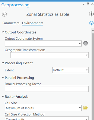

Hello
Resample works, and using it will let you see explicitly which cells are contributing to which zone, but you could also directly specify the desired cell size when executing the 'zonal stats as table' tool. This avoids the need to create or manage intermediate raster datasets. For example, if you use the ZSAT tool from the Pro UI, you can switch to the tool's environments tab and specify the cell size in the Raster Analysis parameter group.
as a general rule, all spatial analyst tools allow you to specify the analysis cell size.
Regards,
-Jim TenBrink
spatial analyst team

Hello
Regards,
-Jim TenBrink
