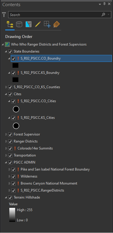

I have a lot of layers that are done in ArcGIS 10.5.1 in Citrix and when I open it in Pro and I have them there but they are showing here in the picture I pasted.
Here is the example of the red exclamation point .
What is the solution for this ?

Never mind. The only way around is to export each layer to File Geodatabase and copy them from Citrix and then put it in the C drive.  Fix them to get each re-source to the c drive.
That is the only way around but it is not that hard to do unless if you have many of them !
