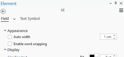

BerendVeldkamp
Oh, but setting the column width is possible. In the Field's properties window under Appearance, simply uncheck Auto width
