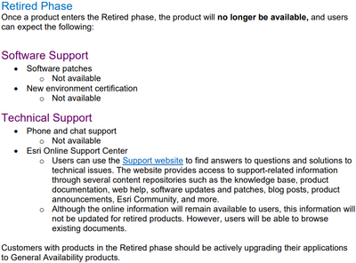

@GIS_Fox Great question and thanks for the detailed notes.
Let's start with some key references:
"ArcGIS 10.8.2 is the current release of ArcMap and will continue to be supported until March 01, 2026 as established in the ArcMap Product Lifecycle."
Keep an eye on ArcMap Continued Support page. So what happens once ArcMap is retired - this is explained at ArcGIS Product life cycle support policy
"While continued support has a timeline, ArcMap does not. If ArcMap is the software that helps you be successful, you can continue to use it, as long as your license is valid. Keep in mind, our desktop development efforts are focused on ArcGIS Pro, and we encourage you to migrate to ArcGIS Pro."
Reference: ArcMap Continued Support Blog
Esri is strongly committed to supporting all user communities while pushing new products and technologies. With that background, let's now address  ArcGIS Pro function to Import an ArcMap document. As noted, this is ArcGIS Pro capability and will be available after ArcMap retirement.  At a distant undetermined  future date, this capability will become obsolete when no MXD's are leftover. I see this migration/adoption timeline driven by users. Esri collects user feedback and provides ample advance notice when removing functions: Removal and deprecation notices
