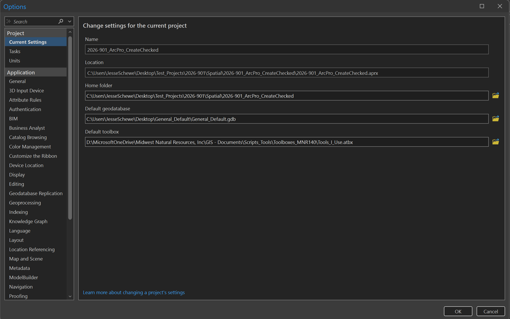

In the following example, the project's home folder is set to C:\Users\JesseSchewe\Desktop\Test_Projects\2026-901\Spatial\2026-901_ArcPro_CreateChecked (Photo 1).
Photo 1Photo 1

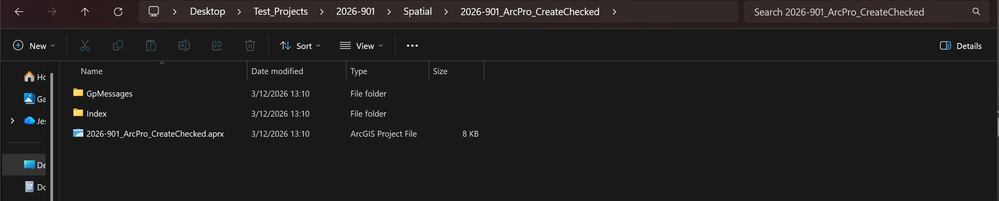

At one point, GpMessages did save to that home folder (Photo 2).
Photo 2Photo 2

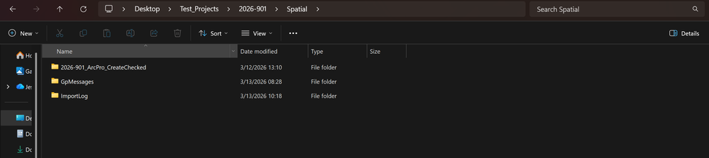

But down the line, GpMessages and ImportLog will jump to the next directory up, C:\Users\JesseSchewe\Desktop\Test_Projects\2026-901\Spatial (Photo 3).
Photo 3Photo 3

ArcGIS Pro writes GPMessages and creates the ImportLog folder in the project’s Home folder (the Home folder is also where Pro stores other “managed” project items). If you ever changed the Home folder, Pro does not move existing managed items from the old Home folder to the new one—so you can end up with GPMessages/ImportLog “outside” the folder you’re currently expecting. This is documented behavior: the Home folder “contains… geoprocessing messages” and changing it “does not move or copy” items from the previous home folder. Change current settings for a project—ArcGIS Pro
Your Default Toolbox is on Microsoft OneDrive.  Esri cautions that cloud storage services such as OneDrive are not supported unless stated otherwise, which can contribute to inconsistent behavior when items are referenced from synced locations. Projects in ArcGIS Pro
