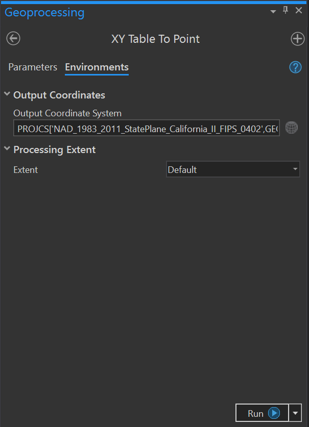

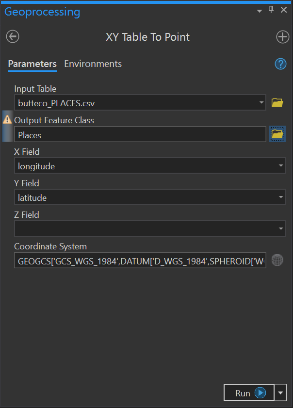

I have three (3) CSV formatted files containing geographic coordinates (I attached one).  When I use XY Table to Point to create point features from any of them, I cannot get valid results if I set both the input SRS and the output SRS (via the Environment settings). In my case, the input SRS is WGS84; the desired output SRS is NAD83-2011 State Plane CA-II (0402).
ParametersEnvironment settings
ParametersEnvironments
The XY Table to Point tool does create points, but it misinterprets the desired output SRS as the defined input SRS and, so, plots all the points near the false origin of the CA-II coordinate system (i.e., out in the Pacific Ocean).
I now have to use a two-step process to accomplish what used to be a one-step process: 1) use XY Table to Point to create point features tied to the input SRS; then 2) use the Project tool to handle the coordinate conversion.
I'm running ArcGIS Pro 2.5.0 on Windows 10 Pro.

Dan, this is a workflow I've been using for years that is now generating unexpected behavior.  I did specify both the input and the output SRS (see the figures in my post).  The error literally occurs when I specify both (as one should if the desired output is different from the input).  The reason I am posting is because this error did not occur in prior versions of ArcGIS Pro and is occurring now.

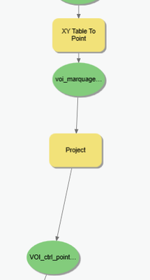

hello,
on pro 2.9 i have got some issues too with this tool. The parameter of the tool "coordinate system" goes suddendly wrong without any manual update on the stuff.
here is the chain i use.
have got the problem both on excel and csv
when i use a second tool "project" the transformation goes wrong too without any manual update.
very disturbing...
