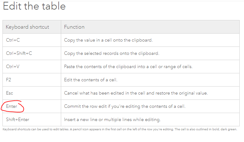

Hmm, are you hitting Enter to commit the last edit before saving?
https://pro.arcgis.com/en/pro-app/help/data/tables/keyboard-shortcuts-for-tables.htm
deleted-user-K9U1SzFzl3f7
Deactivated User
I haven't been hitting enter on the last row. I will from now on, and will report back.
