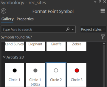

I am on 2.7.  Needed a nice hollow circle symbol.  Had to install a bunch of styles from 10.6; forgot to save before ArcGIS Pro crashed so had to reinstall the styles.  Finally gave up and searched for my preferred symbol style in ArcMap, and now I can search for that particular style and have some chance of getting a map done in less than 10 hours that would've taken about 2 in ArcMap.
KoryKramer
Esri Community Moderator
Hi @AlisonMynsberge Sorry to hear that you ran into a crash.  Before we get to that, does the built-in Circle 2 symbol not meet your needs?
