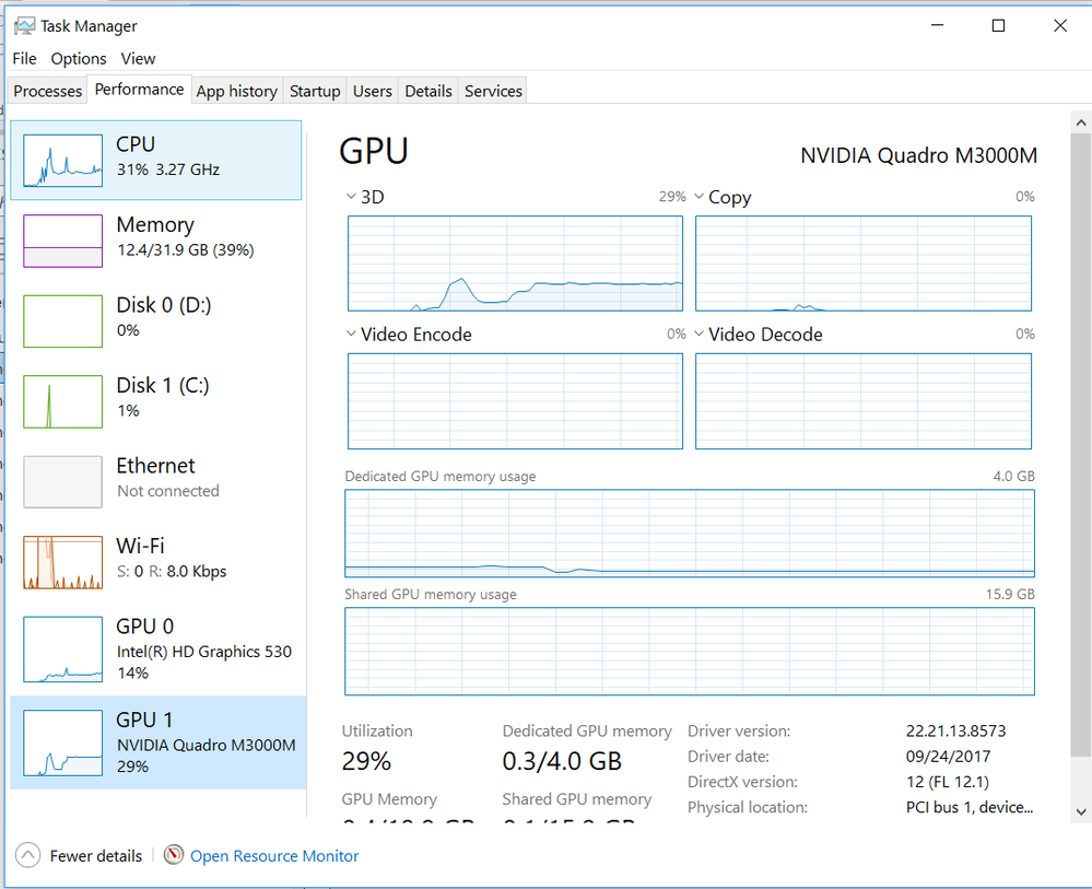

I'm running Pro 2.5.1on a dual core i7-6820HQ with 32MB of ram.  Yesterday while creating a map, I tried to add our standard department disclaimers as a text box on the layout - roughly 240 words of text.  The application had been running smoothly but all of a sudden ground to a halt, as it tried to process such a large text box.  The paste operation of the text took about 5 to 10 minutes, then setting all the appearance settings life font, color and size, took about 30 minutes to complete.  Then once it was all placed and I didn't need to touch it again, Pro went back to nearly normal performance, running at what felt like about 80-90% of the speed it had been at before that text box was added.
Tried it again, watching the performance stats - GPU and CPU ramp up to 33% from 1% but the biggest spike is network traffic - I haven't even saved my edits to the file and already it's doing this?  What is it doing exactly?
