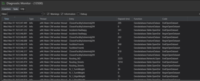

In Pro 3.0 we seem to still be seeing these long runtimes for seemingly simple tasks like object deletion, name changes, etc. I also just ran into a significant slowdown of a notebook I was working with that had been functioning fine prior. A createFeatureclass cell that was running almost instantaneously now will take almost 2 minutes and a big long cell of a bunch of AddField operations takes forever to run.
During this process, I decided to open up the Diagnostic Monitor and noticed that the Main CIM worker thread was iterating through every object in my database connections several times and opening / closing the dataset for some unknown reason. Maybe there is a more advanced programming reason for seeing this behavior like backup management if an error is produced, but these datasets were in different databases and completely unrelated to the current task. I saw the same behavior just when deleting a Feature Class (see the screenshot below, also attached). All those dataset objects listed are not even in the same database as the Feature Class that was deleted. Not sure if this is useful information, but seemed like odd behavior to observe.
