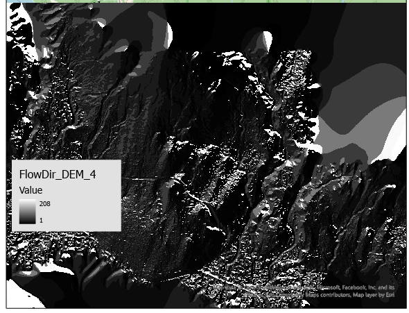

Why I got other values aside from the eight valid output directions when applying flow direction to elevation raster cells?
782
1
05-18-2022 06:17 PM
VannarySeng
Hi, I am using ArcGIS Pro 2.9.0. I would like to know why I got other values aside from the eight output directions (1,2,4,8,16,32,64,128) when I applied the flow direction tool to my elevation raster cell (DEM). I used the sink function to see whether those values correspond to sinks. It seems that was not the case. However, It output correctly if I used the fill tool on my elevation raster cell before applying it to the flow direction tool.
I would like to know what the other values mean and how to get the correct flow direction output without using the fill tool because I would like to keep the depression points in my raster.
Thank you
1 Reply
Luke_Pinner
MVP Regular Contributor
What flow modeling algorithm did you specify?
D-Infinity (DINF) output is angle in degrees going counter-clockwise from 0 (due east) to 360 (due east), not the D8 direction codes (1,2,4,8,16,32,64,128).
