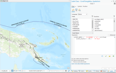

This Python label properties expression ought to add a new line but it fails to do so.  Any clues are appreciated.
[Contour] + ' ft NAVD88' + '\n' + str(float([Contour]) + 0.79) + ' ft MLLW'

I think you're confusing multi-line labels with multi-line expressions. This single-line expression works properly in my testing.

You didn't have "Remove extra line breaks" checked maybe?  I tend to use '\r\n'
GerryGabrisch
I did try '\r\n' to no avail before posting.  Remove extra line breaks is unchecked.
