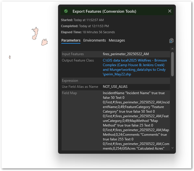

Why does it take so long to export a small feature class to shapefile?

Why would it take almost 19 minutes for ArcGIS Pro to export a fairly simple feature class from a file geodatabase (.gdb) to a shapefile (.shp). Both source and export locations are near each other in the C:\ (hard drive) of the machine. Pro is a very recent version and the .gdb matches that version. There are only three (3) polygon features in the feature class!

If that applies, but 18 minutes for 3 features is certainly not expected.  Give this a try if your output is simple
Copy Features (Data Management)—ArcGIS Pro | Documentation

I almost replied "...nah, this isn't causing the issue" (being very 'certain' that I didn't have any subtypes or domains set up in this database). But when I actually checked, I was surprised to see a bunch of domains that were apparently carried-over into the database at some point. Which shows you have to pay attention to the origins of your geodatabase, and what you import into it. The layers associated with those domains were long gone from the database, but the domains remained.
Thanks for mentioning this as a possible cause.
