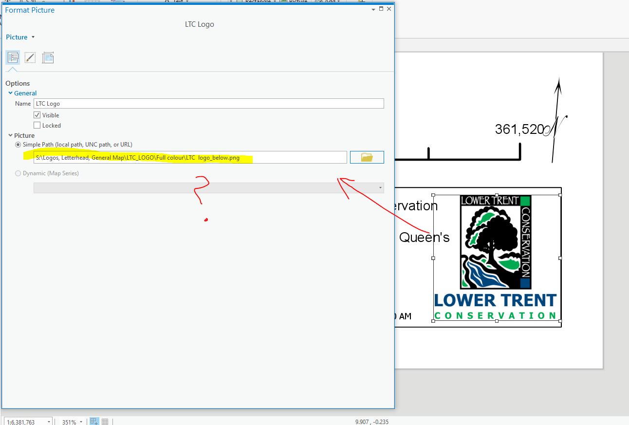

Kory Kramer‌ I haven't tried to repro (it looks like the issue might be happening when there are 100+ layers?), but:
Note the commas and spaces in the path and that the path is populating:
