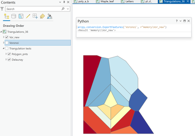

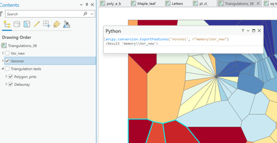

Export Features works and even supports selections (see pre and post script images
... sort of retired...
