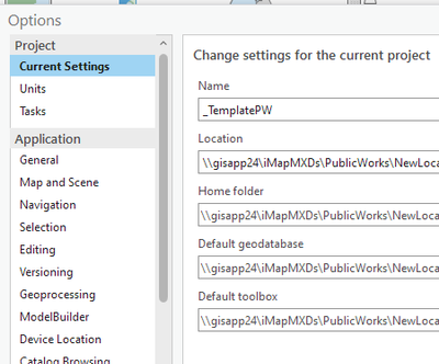

I normally just copy the aprx, the toolbox and the default.gdb to the new location.
then, when I open it from the new location, it has automatically updated the defaults for the project.
If not (because I didn't copy toolbox and/or default.gdb, or want them in different location) you sometimes have to update the locations in the options dialog:
