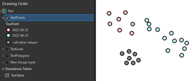

If you don't have one already, create a feature class for the trees (probably points) with a text field. When you planned the tree, fill out the text field with the current date (you could also use a date field, but working with date fields becomes tiresome later on [time zones, different sql formattings etc.]).
Symbolize the trees by unique values:

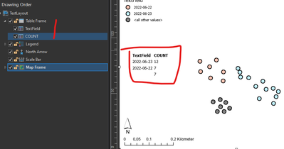

Use Summarize Attributes to create a table containing the dates and a tree count for each date:
In your layout, insert a table frame, point it to the summary table, show the date and count fields:

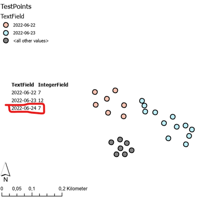

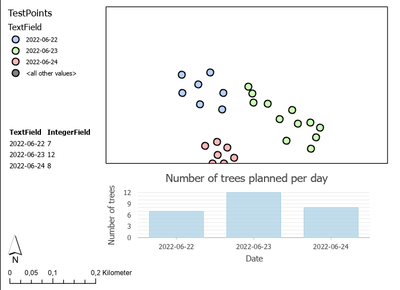

Now, when you update a tree feature, the entry in the summary table with today's date will be inserted or its count increased. If you point your table frame to the new summary table, the changes will be reflected there:
You will probably still have to refresh the symbology after each day...

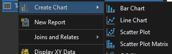

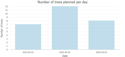

Also, charts!:
Have a great day!
