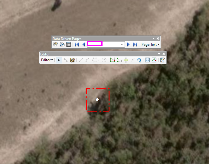

This is what I want to be able to do in Pro.
Run DDP in a map to edit items while viewing visual context. Bring the toolbars needed in close to reduce mouse movement.
