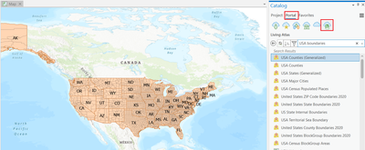

You could access the State/ County boundaries from ArcGIS Living Atlas.
Then use Definition Query to filter the desired State/Counties.
