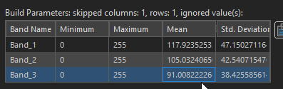

1. I think so. When I go to the raster properties and look at the statistics section, I see this:

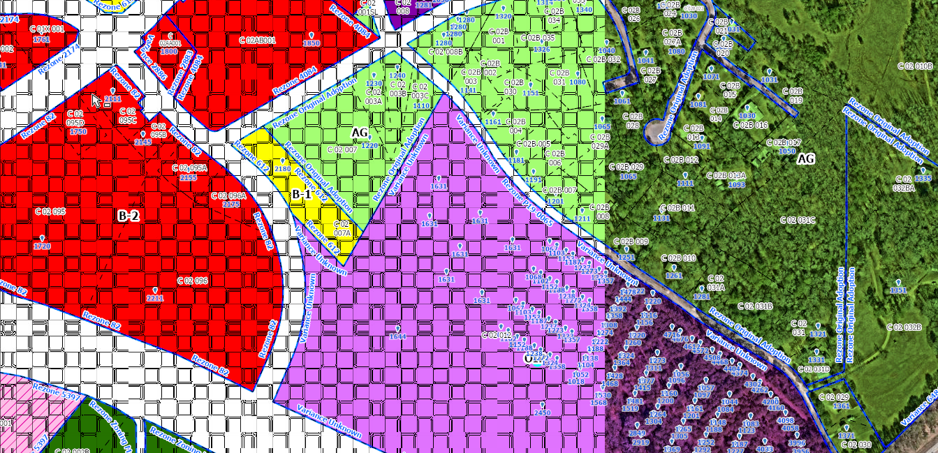

Here is a screenshot showing one example of the issue occurring. When I zoomed out to ~1:8000 it began to redraw normally until zooming back in.

Well, I have not seen that pattern before with a raster dataset of any kind. I would use the mosaic dataset footprint to find out which raster that is and add that individual raster to the map and see if it has the same issue.
