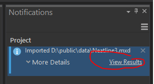

When you import the MXD into Pro look to see if you have any notifications in the upper right hand corner of of the application.
If the "bell" has a blue dot you have a notification.  Click this and the Notifications pane should open. Here you hover the mouse over "More Details" and click View results.
This should open a browser where you can read the notification details.

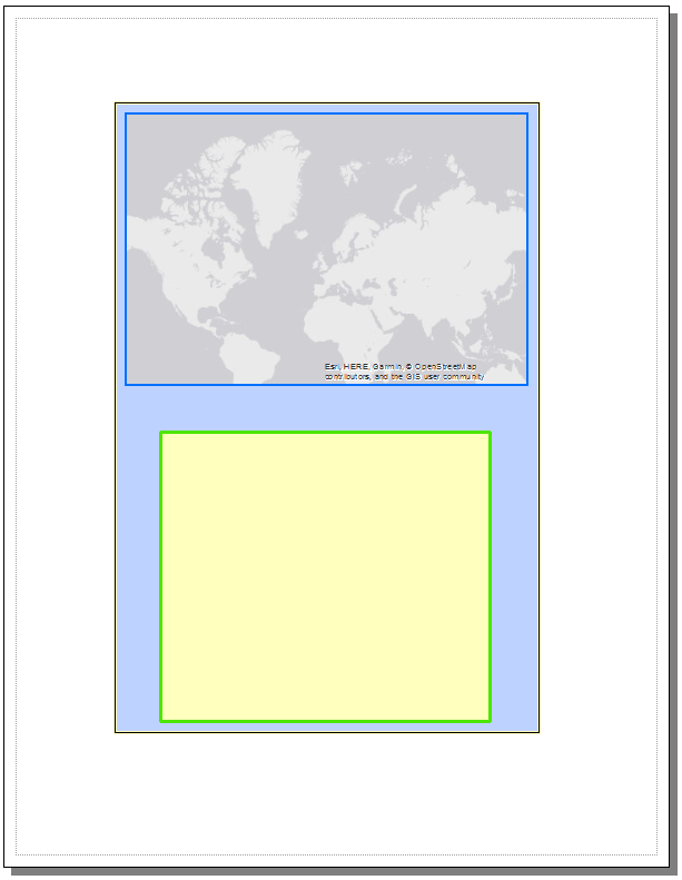

For example, here is a simple MXD with a data frame (blue border), a rectangle (green border) and a neatline element (yellow-black outline with blue background).

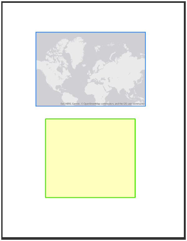

When this MXD is imported into Pro the neatline element is dropped.
Unfortunately, you will need to replicate the neatlines in ArcMap with rectangle elements in Pro.
