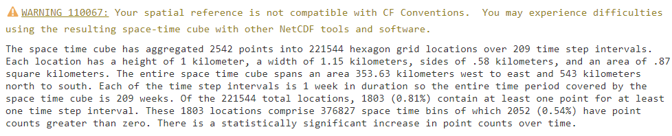

It was suggested to me to use a Space Time Cube analysis. I trialed creating the STC by aggregating points and I am receiving the following warning:
I would only consider myself a novice with ArcGIS Pro and definitely not familiar with CF conventions, which I did look at but it's Greek to me.

Hi @Jill_Clogston,
The message from the tool is an informational warning rather than an error.  It does not mean that your analysis is invalid or that there is a problem with your data.
CF Conventions are a set of standards for how to store and label data in a netCDF (NC) file.  NC files are generic data containers and do not have to abide by these standards; however, some non-Esri software will only work correctly with CF-compliant netCDF files.  If you intend to perform your analysis entirely within ArcGIS, this is not a problem, and you can ignore the warning.
While I do not know which projection you are using, the warning indicates that it is not one that is part of the CF Conventions.  You can likely resolve the warning (which, again, may not be required at all) by projecting your original points to a more common coordinate system.

Hi @Jill_Clogston,
