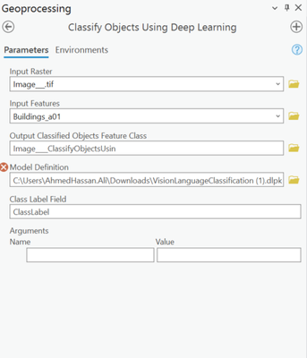

I have a problem importing the Vision language classification model in the classification after using the "classify object using deep learning" toolbox

what is the red X indicating? and punctuation in a filename is never a good thing

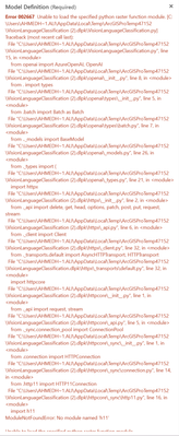

it seems that most of the packages are missing but it exists in the Arcpro Python environment

002667: Cannot load python module.—ArcGIS Pro | Documentation
I would begin with solving the issues raised by the error message
Is this what you are using?
Vision Language Context-Based Classification - Overview
if so, check out that pages requirements as well.
Also move the file from the downloads folder into a simpler path and get rid of the punctuation when you rename it
