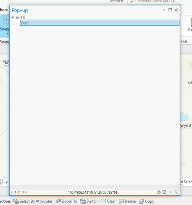

  1. You can change what the feature is named in the popup by going to label properties--> displayAlfredBaldenweck_0-1734642011436.pngAlfredBaldenweck_0-1734642011436.png

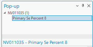

  2. I have users frequently accidentally hide the actual popup information.AlfredBaldenweck_1-1734642053454.pngAlfredBaldenweck_1-1734642053454.png

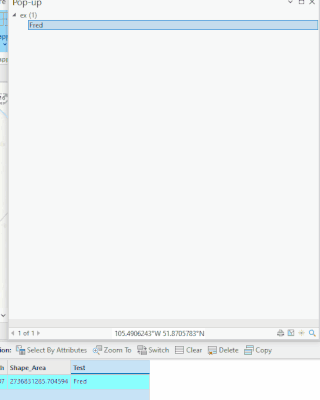

    1. When this happens, hover your mouse down at the bottom right, north of the magnifying glass, and you should be able to bring it back by adjusting the windowAlfredBaldenweck_2-1734642216313.gifAlfredBaldenweck_2-1734642216313.gif

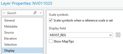

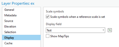

The Pop-up displays the contents of what is designated as the Display Field in the top section. This is set by default to the first Text field with "name" somewhere in the field name or if non exists, to the first Text field. You can manually set this under Layer Properties --> Display --> Display Field.
As for not seeing all the field contents, look for a solid grey bar in the Pop-up pane that separates the Top and Bottom parts of the Pop-up. The bar can be dragged up or down to create space as needed. There are three little widgets on the right side of the bar that let you hide the top, bottom or otherwise reconfigure (split) the Pop-up. Hover over these to see their tip.
If for example you click the Hide Bottom widget
BarryNorthey_2-1734642810957.pngBarryNorthey_2-1734642810957.pngonly the top section remains and the grey bar moves to the bottom. You can grab the bar and drag it up to expose as much of the lower section as you want.

Thanks, I followed how to change the display field. Is it possible to get it to display more than one field though?
Robert_LeClair
Esri Esteemed Contributor
Yes.  In the Layer Properties->Display, click on the "X" to the right of the primary display field and using some custom Arcade, you can have as many fields as you want in the MapTips popup.
