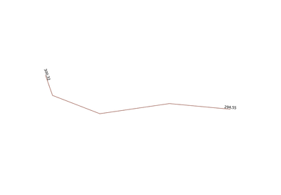

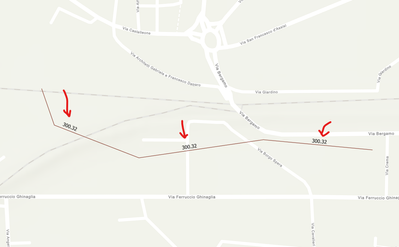

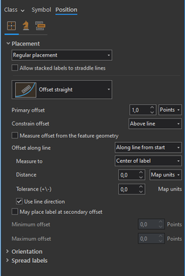

ArcGIS Pro, very simple Polyline with two classes for different information.
Label placement "Along line from start" for one...
...and "Along line from end" for the other.
This is the result in ArcGIS Pro
And this is Vector Tile on ArcGIS Online...same label repeated instead of two separate labels classes
