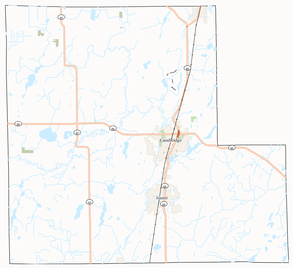

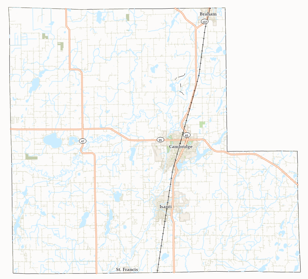

Following the "Design and Publish Basemaps" tutorial found here, the image below is the finished vector map, ready to be packaged and published.
Using "Share to web Layer" gives me this result:

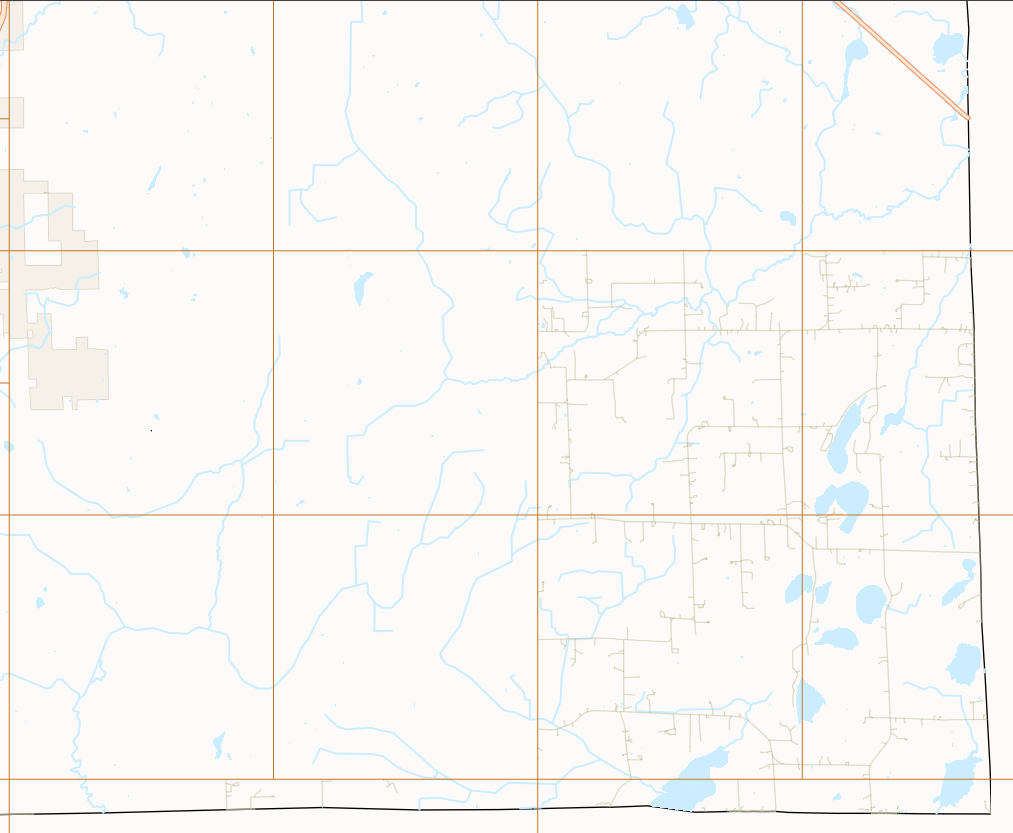

Zooming into the lower right corner of the map, some of the features appear. On the image below the tile index is overlain (orange grid) and it suggest that there is a problem with feature (point) density vs tile index.
I've tried to create tile indices with different Vertex Count, but nothing seems to fix the problem. I suspect it might have something to do with alternating symbols being used at different scales, but I'm not sure.
