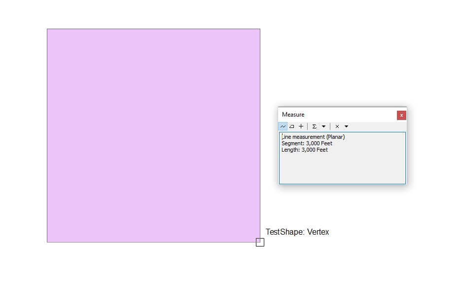

I work in county government and we are currently in a transitional phase in GIS software - we currently use both ArcMap 10.8.2 and ArcGIS Pro 3.2.0.  We've recently noticed some odd discrepancies in reported distances after splitting polygons in a shapefile in ArcGIS Pro and then viewing that same shapefile in ArcMap.  We are using the same county coordinate system and units (US feet) in both versions of the software.
For example, I'll create a simple square polygon in a shapefile in ArcGIS Pro that is exactly 3000 ft by 3000 ft:
I then open the same shapefile with the same coordinate system in ArcMap 10.8.2 - everything measures out as it should:

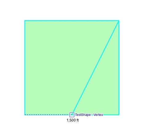

However if I take that same polygon in ArcGIS Pro, measure exactly 1500 ft from a corner and split off a portion:

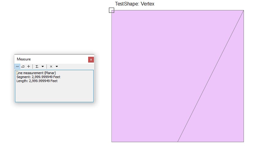

It appears like this in ArcMap 10.8.2:

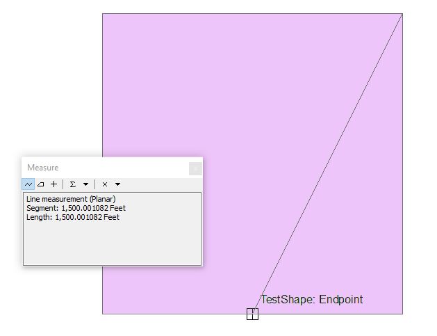

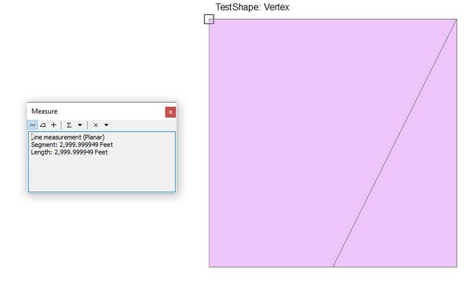

Instead of the 1500 feet as it was split in Pro, it now shows the measurement from the corner to the split location as 1500.001082 feet.  The split also seems to have modified the north/south dimension as well:

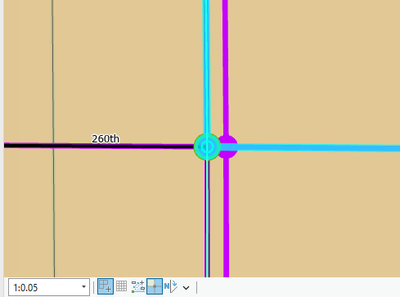

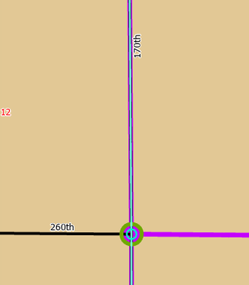

In the following images I split a polygon by tracing a road.  The first image shows that the polygon boundary and roads are all perfectly snapped,  The second image shows that the new polygon no longer is aligned to the road or the other polygon(s) that were not split.  Is this a bug?
Scott_Harris
@LyonMNGIS I suggested topology as way to find out more information in researching if this was a bug.
In your screenshot, you show the map scale being 1:0.05, approaching the XY resolution and XY tolerance of the data. If I had to guess, the distance between the points is within the XY tolerance, but hard to tell from here. A topology might help answer that question.

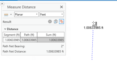

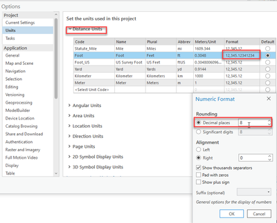

@MErikReedAugusta FYI you can get more precision from the measure tool in ArcGIS Pro. You just have to change the numeric formatting of the Distance Units that you are measuring in:

@JoelCrawford2, go into these settings and set your distance unit to be 6 decimal places, and repeat your experiment.  Are the numbers still different, or are they the same?

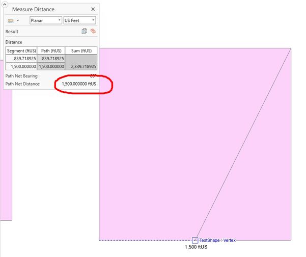

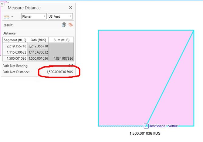

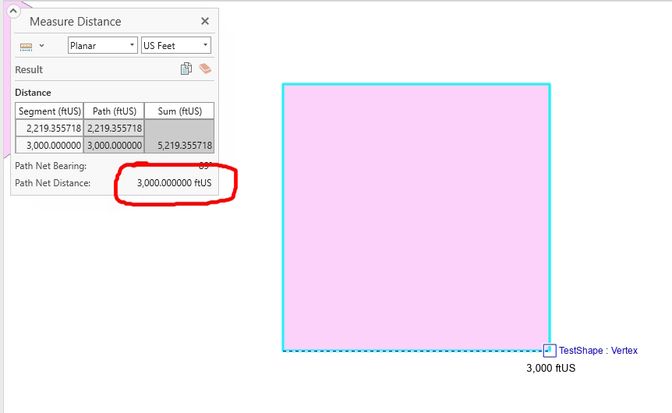

@MErikReedAugusta  - I was thinking the same thing.  I changed my measurement settings in Pro to match the six digits I see when measuring in ArcMap.  Repeating the experiment, I created another 3000 x 3000 ft square in Pro - note the measure tool shows this as 3000.000000 ft US:
Then, I split the polygon at exactly 1500 ft.  The difference this time, is with the extra digits being displayed I'm now seeing the 1500.001036 ft US as I would see in ArcMap:

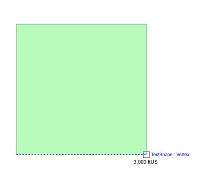

Finally, as an added experiment, I created a the same square in ArcMap, and split it at 1500 ft in ArcMap.  It measures out as exactly 1500 feet in both ArcMap and Pro:
This appears to confirm that there is a different process/unit conversion going on when splitting polygons in ArcGIS Pro vs. ArcMap.  I did test out a topology rule to make sure I'm not getting splits/overlaps, which I am not since these numbers are smaller than the standard XY tolerance.
However, I still think we shouldn't be seeing changes in dimensions in Pro (no matter how small) when performing splits, because we didn't see those changes when performing splits in ArcMap.
