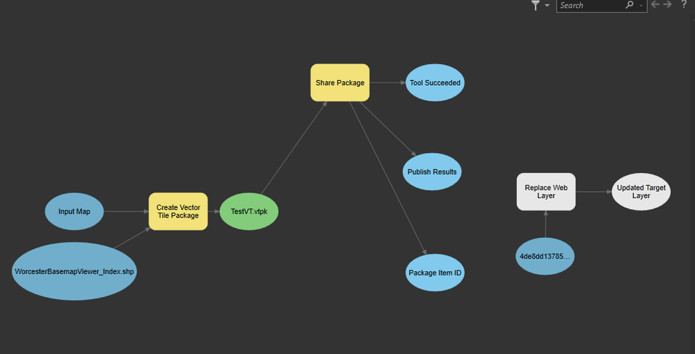

I'm relatively new to ModelBuilder and am trying to create a model to automate the process of updating vector tiles on my organization's enterprise portal. I've included the Create Vector Tile Package, Share Package, and Replace Web Layer tools in the model. I'm having trouble figuring out how to connect the Replace Web Layer tool. In order to run that tool, I need the Package Item ID that is generated from the Share Package tool to use as the "Update Layer" input. I've tried adding the Package Item ID as a precondition of Replace Web Layer but that doesn't do the trick. Any suggestions on how to connect it properly would be appreciated. Thanks, SamaraModelbuilder.pngModelbuilder.png

HI @WorcesterGTSS , were you able to figure this out? I am working on a similar project. I also am getting hung up at the same spot. Thanks.
-Jim
WorcesterGTSS
No I never figured this out. I was exploring the option of referencing registered data for the vector tiles instead but I haven't been able to test this out to see if it actually works for us.
seanchambers1
I too am having this same issue.  Have there been any updates?
SteveCacioppo
 @WorcesterGTSS , were you able to figure this out? I'm in the same boat as the others.
WorcesterGTSS
Unfortunately no - I'm planning to take another look at this soon and see if I can make some headway though. I'll definitely post an update here if I do.
