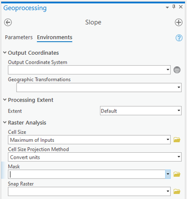

I am doing a slope analysis.
I have features from a larger set of features selected and turned into a layer.
I am using that layer of selected features as the mask.
When I run the spatial analyst slope tool and set the mask and extent to that layer (those 3 features) the analysis returns a raster data set that is masked by all the features in the parent feature class and is not limited to the selection.
I have tried this many types of raster and features.
If I export the selected features and write it to as a separate feature class.
This is similar to prior issues where the selection reverts to the whole dataset.
This is a difficult problem to debug in model builder workflows.

What data type is the feature class that you are using as the mask (raster, polygon)?
I would set the mask in the environments tab of the slope GP tool AND set the processing extent using your mask feature class , or clip the raster to your mask layer and then perform the slope analysis.

I'll clarify my settings:
  • Selected parcel boundaries from a polygon feature class in a file geodatabase.
  • Turned selected features into a separate layer (did not export as a new feature class) under the selection options under the context menu after right clicking the feature class with selected features in the contents pane.
  • Added DEM raster from file geodatabase.
  • Confirmed vertical units of measurement for raster and horizontal units of map and analysis environment were the same for correct calculation of slope.
  • Opened slope tool.
  • Set DEM for input.
  • Set projection for environment settings.
  • Set selected polygons added as layer  in map contents as mask (no features in that layer were selected)
  • Also set selected polygons layer as analysis extent/processing extent under the environments settings
  • Ran slope analysis.
    Slope tool calculated slope.
Slope tool did not calculate whole raster, it did a mask.
However, from the results it is clear that the mask used all the parcel polygons in the underlying feature class, not the set of three polygons in the layer chosen as input.
Because the mask was not limited to the features in the layer that was chosen as the mask input I believe this is not the expected behaviour.
While the work around as a one-off solution is good, creating extra steps in a model that require the creation, deletion, and confirmation of deletion of multiple sets of additional data in the process means I can't make use of the speed and efficiency of the mask- especially in an iterative model.
I suspect this is a bug.
Or... if it is true that layers created from selections cannot be used as a mask input then this should be noted in the slope tool documentation.
