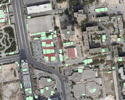

I want to try footprint extraction with deep learning in Azerbaijan.  I downloaded and tried building footprint extraction .dlpk file but the result was not good. Probably because it's for USA. Is there a way to get good results from the area I will try?

You're right, the model is trained with USA imagery where building topography can be different. As we speak there are 4 ready to use ArcGIS Pretrained Building Footprint Extraction models for different geographies:
Africa: https://lnkd.in/gHJi64Xp
Australia: https://lnkd.in/gjS9B5aG
China: https://lnkd.in/geQa-bjM
USA: https://lnkd.in/gR7CEhaU
You can fine tune (retrain) the USA model with some of your training data. Here are  examples to learn how you can fine tune (repurpose) existing models
Repurposing Deep Learning Models using Transfer Learning in ArcGIS
Fine tune a pretrained deep learning model
Finetuning Pre-trained Building Footprint Model
