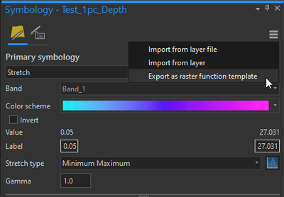

Thanks. I can see that we are trying to apply two different visual functions, so they can't be chained. But the stretch function should allow you to apply a colour ramp.
It's also supposed to be possible from the Symbology tool:
But this method doesn't work for me either. It manages to apply the correct color ramp, but seems to now think it's an RGB raster, and I lose access to the original band data.
Time to lodge a case for this method - or try and hack the Raster Function xml 😕
