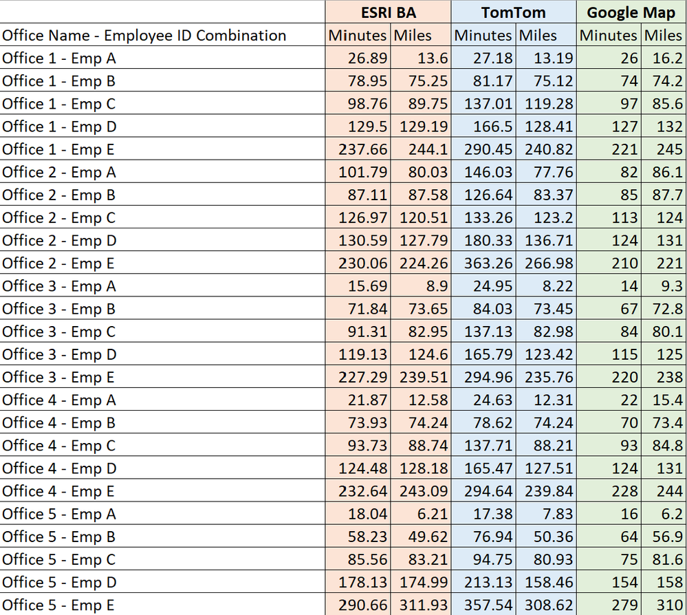

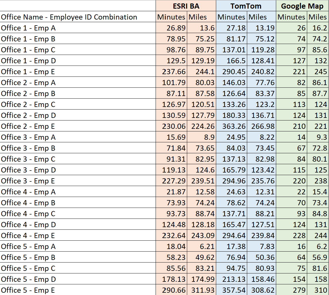

I tried to create, configure, and build a network dataset based on TomTom data, and then ran the Cost OD Matrix analysis based on a sample of 5 office locations and 5 employees in Wisconsin. However, the result based on TomTom data looks different compared to the results generated from ESRI and Google Map. The miles are fairly close, but looks like the employee would take more time to drive from home to the office based on TomTom data calculations.

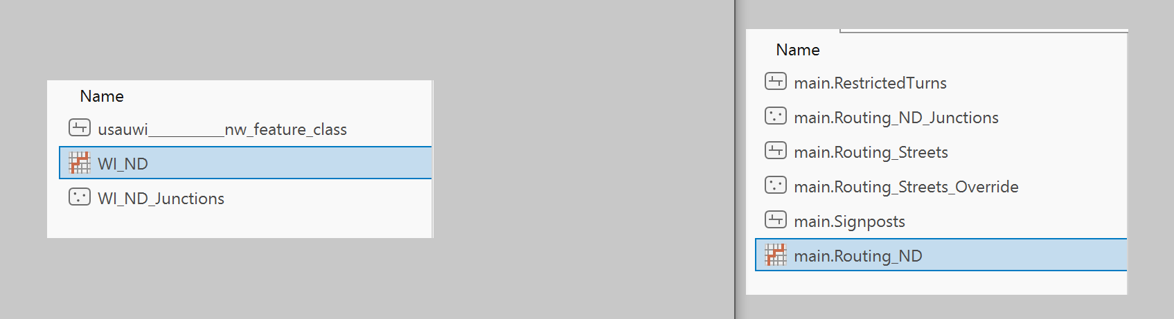

I compared the network dataset properties between TomTom network dataset and ESRI BA Routing_ND dataset. I find that there are more feature classes along with the Routing_ND network dataset in ESRI's geodatabase (left is my data, right is ESRI data). Do not know if this difference would affect the miles and minutes calculations that much.feature_class_compare.png

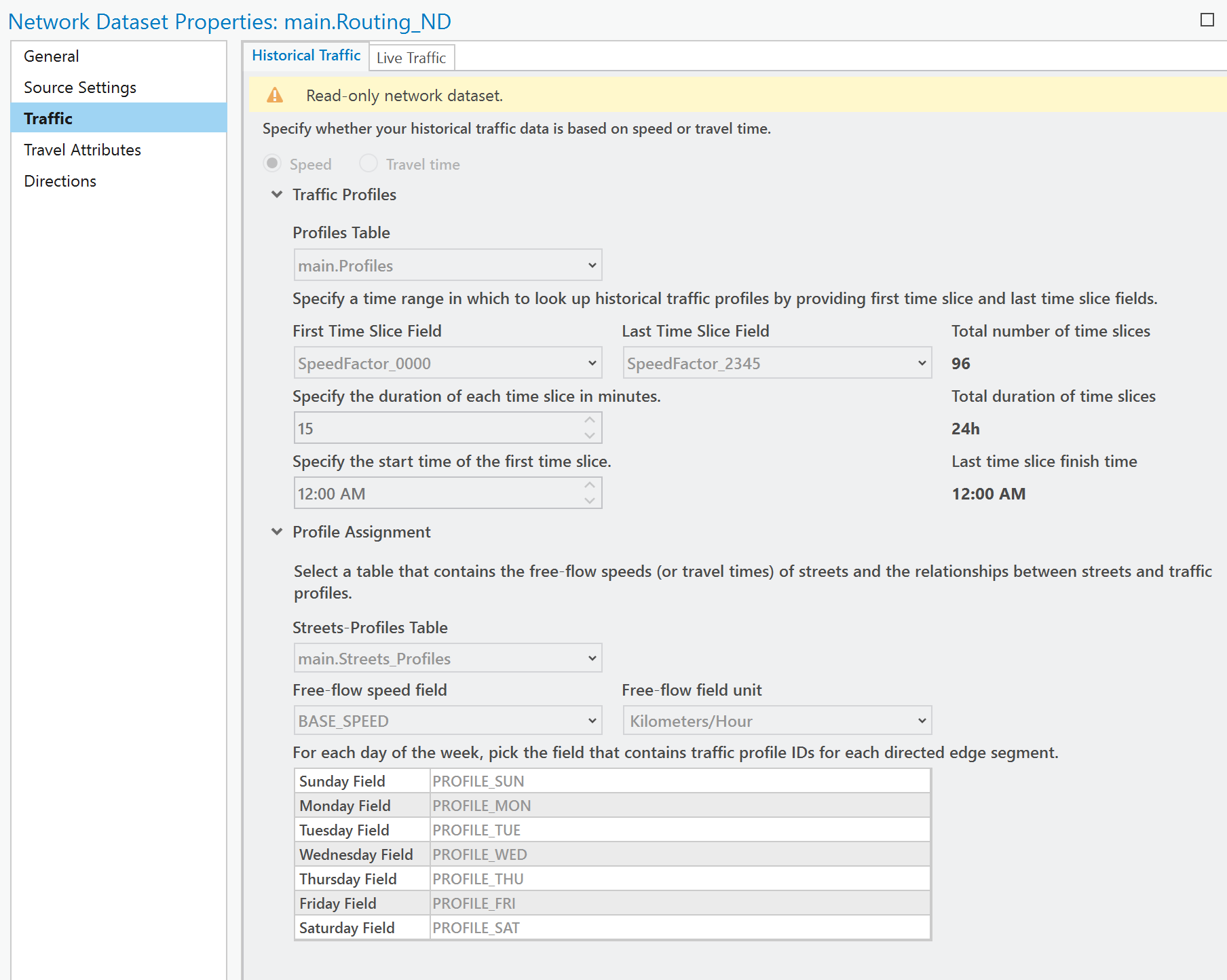

In addition, because I used "Create Network Dataset" tool to create this WI_ND network layer, so the "Traffic" section in the properties is not supported. But ESRI Routing_ND dataset has the "Traffic" section configured. Do not know if this difference would affect the miles and minutes calculations that much.routing_ND.png

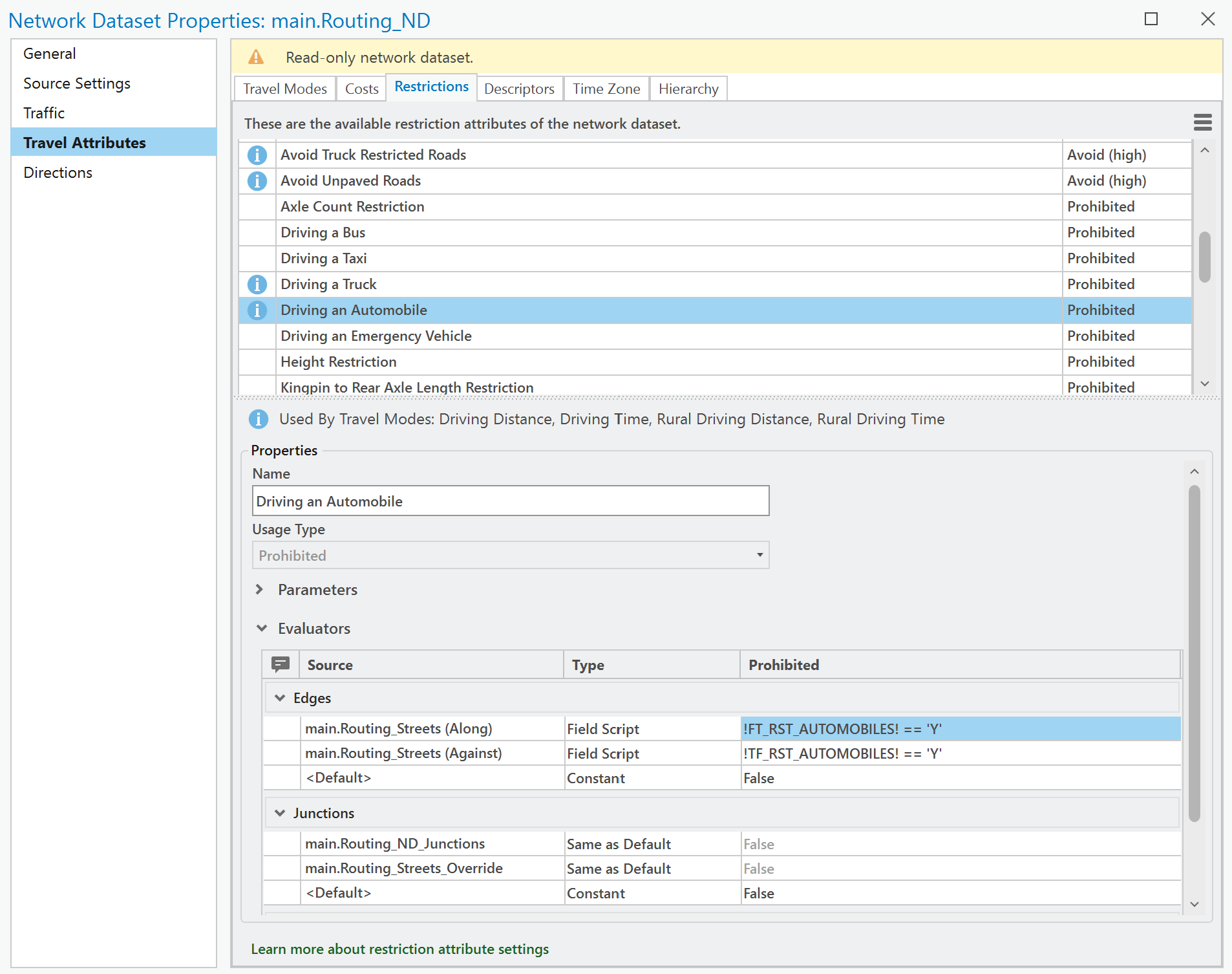

The attributes in TomTom network dataset are different from the attributes in ESRI Routing_ND as well. For example, I could not find an equivalent of this "FT/TF_RST_AUTOMOBILES" attribute from ESRI routing_ND dataset in TomTom data because I need it as an active restriction (prohibit an automobile) when I perform OD Cost Matrix analysis. The screenshot below shows the settings in ESRI routing_ND dataset.automobiles.png
