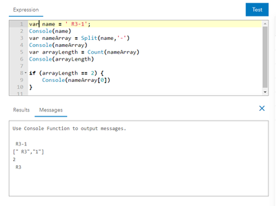

Five minutes in the ESRI Arcade playground and I came up with this:
var name = ' R3-1';
Console(name)
var nameArray = Split(name,'-')
Console(nameArray)
var arrayLength = Count(nameArray)
Console(arrayLength)
if (arrayLength == 2) {
    Console(nameArray[0])
The Console() function is like the print() function in python, but it only works in the playground.  This is nothing more than python logic in Arcade...
That should just about do it....
