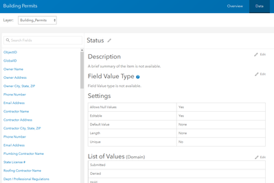

Okay, that's what I thought, but your mention of subtypes made it a little unclear. Hosted layers don't currently support true subtypes, just simple domains on the fields. Those domains can be altered in AGOL from the item's Data tab if you go into the Fields view.
