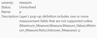

 These fields are nowhere to be found in the attribute table. They are only appearing in the pop-up. The error I'm getting is: "24138 The pop-up definition for this layer includes measurement fields that are not supported online ArcGIS".

There is this Support article that talks about these fields being in a pop-up.  For the layer in question, you could edit configure your pop-up to not show these fields and attempt in republishing the web map.

The problem is with one of your feature layer with M-values field, which store the linear mesurements. If you have created a new shp file, try to create a new feature layer with z-value instead of shp file without m-value field.
Useful link in regard to your issue
This is just a popup message not a feature layer attribute table screenshot.
