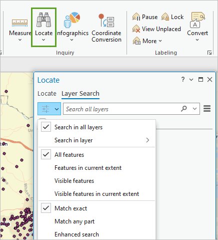

If have multiple feature layers on a map and I got a globalid of one feature, but I don't know which class it belongs to, how can I do a universal search to select that feature without knowing the class?

Hi Billy, try the Locate tool - it lets you search within layers on the map, with various options.

Thanks, this works.
